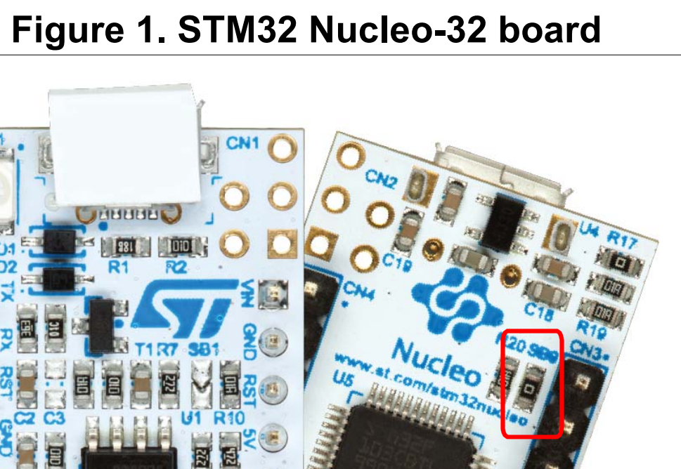

@DavidL_ wrote:How would I „break“ this link? What exactly does that mean?
It's here:
The photo in the UM shows a zero-ohm resistor fitted:
To break the link, you need to remove that zero-ohm link.
There's no need to be particularly careful with it - you don't need to keep it - so just heat it up with a soldering iron until it comes off.

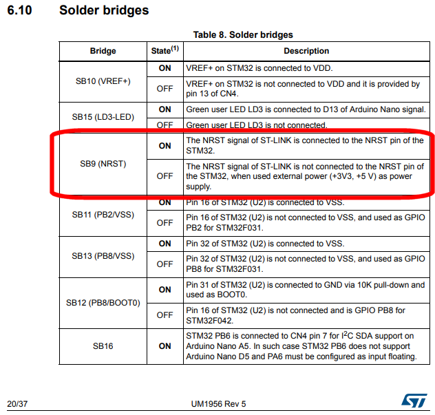

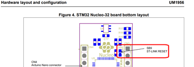

@Andrew Neil wrote:
There should be a link you can break to disconnect the NRST signal.
It's SB9:
