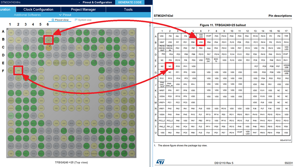

For a redesign of an already existing product we're using an STM32H743XI, which is a TFBGA240+25.
The BGA balls "B6" and "F2" are documented in two different ways in the datasheet and in CubeMX, see also attached picture.
Can you tell me which one is the correct pinout?

I think the Cube map is wrong, the STM32H745 data sheet is more informative.

Thank you for pointing to the 745ig datasheet. I take the datasheet information, and will ignore the CubeMX pinout, as I think it is just plain wrong.
Funny side note: It seems that there's a *third* version of the pinout of balls B6/F2 used in the Eval-Boards.

The datasheet is the reference, the error is on CubeMX side.
It is reported internally.
