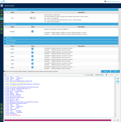

Hello! I'm new to STM32 hardware, and I'm having some difficulties getting it running on my Black Pill board with an STM32F411CEU6. It has both Read and Write Protection enabled, and I am trying to disable them using STM32CubeProgrammer through an STLINK V2. However, upon trying change option bytes, it gives me a weird error.
For attempting to change read protection from value 0xFF to 0xAA it gives me this:
16:24:25:038 : Error: Expected value for Option Byte "RDP": 0xAA, found: 0xFF
16:24:25:044 : Error: Option Byte Programming failed Or modified by application after OB_LAUNCH
And similar story for trying to change the write protection values from true to false for all flash sectors:
16:26:41:386 : Error: Expected value for Option Byte "WRP0": 0x0, found: 0x1
16:26:41:391 : Error: Expected value for Option Byte "WRP1": 0x0, found: 0x1
16:26:41:395 : Error: Expected value for Option Byte "WRP2": 0x0, found: 0x1
16:26:41:399 : Error: Expected value for Option Byte "WRP3": 0x0, found: 0x1
16:26:41:408 : Error: Expected value for Option Byte "WRP4": 0x0, found: 0x1
16:26:41:416 : Error: Expected value for Option Byte "WRP5": 0x0, found: 0x1
16:26:41:428 : Error: Expected value for Option Byte "WRP6": 0x0, found: 0x1
16:26:41:436 : Error: Expected value for Option Byte "WRP7": 0x0, found: 0x1
16:26:41:441 : Error: Option Byte Programming failed Or modified by application after OB_LAUNCHI am on Linux, and the software recognizes the MCU type and ID, so I believe the connection is good. Any help would be appreciated!

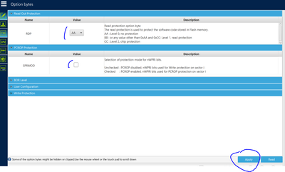

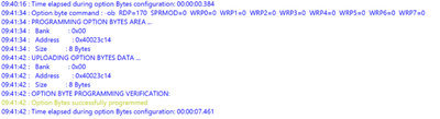

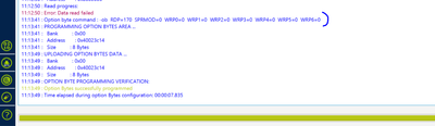

hello @breynard ,
I have tried on nucleo board because I don't have Black pill board, and no issue come up on my side.

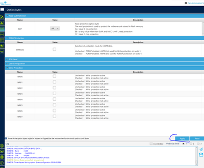

What I suggest is to modify both OPT RDP and PCROP SPRMOD byte the first time to see if you've always got the same message :
1/
On my side this work fine.
2/ but by modifying all it works as well :

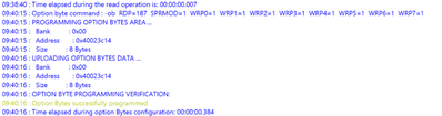

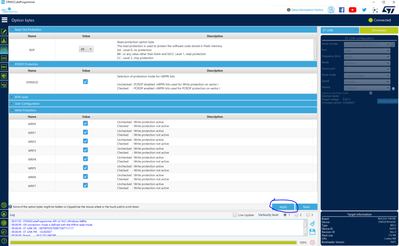

When you connect the first time you should have this message when RDP=0xFF, and others set to 1 :
indicating your memory is protected. But you can always program OPTION bytes
Best regards
Mikael

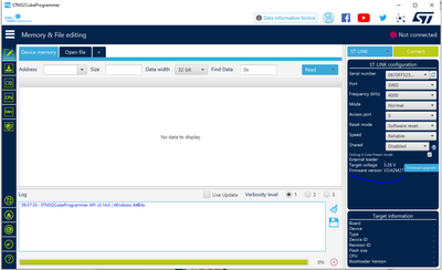

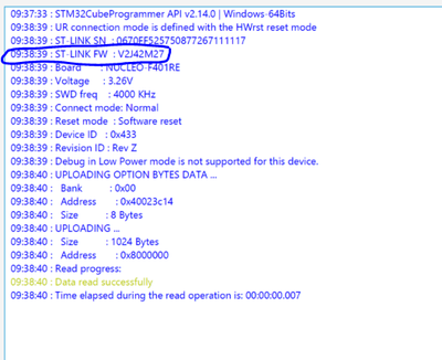

Time elapsed during option Bytes configuration: 00:00:01.734One thing I did notice is that my ST-LINK firmware is version V2J39S7, while yours in the screenshot is V2J36M26. I don't know if that is significant, and I also don't know how to update the firmware should I need to. I realize as I'm typing this that I misspelled the WRP option bytes, but the RDP and SPRMOD bytes still failed in the same fashion.

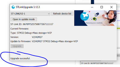

2023-09-19 12:51 AM

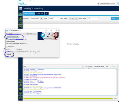

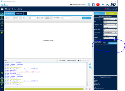

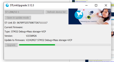

to upgrade STLink fw :
(close your programmer and power on/off your target if needed) then
then come back to level 0 :
I did this with a nucleo board with STM32F401 chip but it must be the same with a STM32F411 chip.

I successfully updated the firmware on the STLINK, but still no luck with the issue; same error. I do not have a Nucleo board on hand, and would rather not spend the money unless absolutely necessary. However, I can return and rebuy either/both the board and the STLINK, free of charge. Which would be the better one to try a new one, and is this even something I should do?

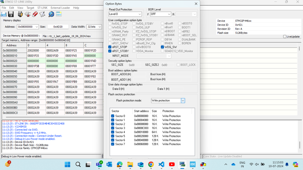

Try using
"STM link utility"
Target>Option byte>Flash protection mode
