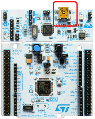

So this "ARM processor" has a USB Device connection.
The CN1 USB connector on your Nucleo board is also a USB Device connection:
You cannot connect two USB Devices together - a Device can only connect to a Host.

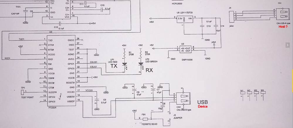

2024-09-25 2:09 AM
What is CN2?
Is that a USB Host port?

@harry123 wrote:
- I want to have communication between Nucleo and Processor
The CN1 USB connector on your Nucleo board is a USB Device connection for the Virtual COM Port (VCP) in the ST-Link:
To use that, you must connect it to a USB Host port. That's the way it works.
Instead of using this USB connection, could you use a direct logic-level connection to one of the UARTs on your ARM9 board?

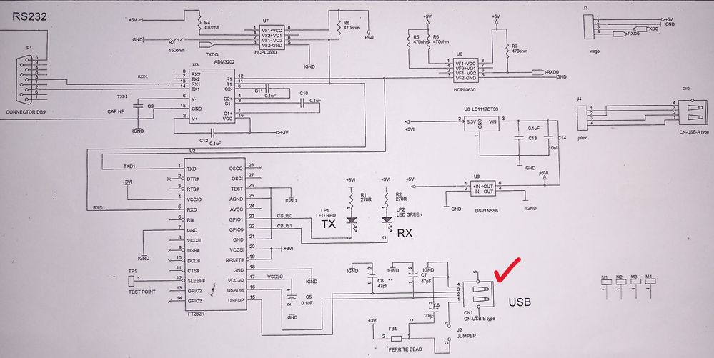

2024-09-25 3:36 AM
@harry123 wrote:
- YES That USB type A port is used to interface a printer
Does it support a Hub - then you could use it for both the printer and the ST-Link VCP ... ?

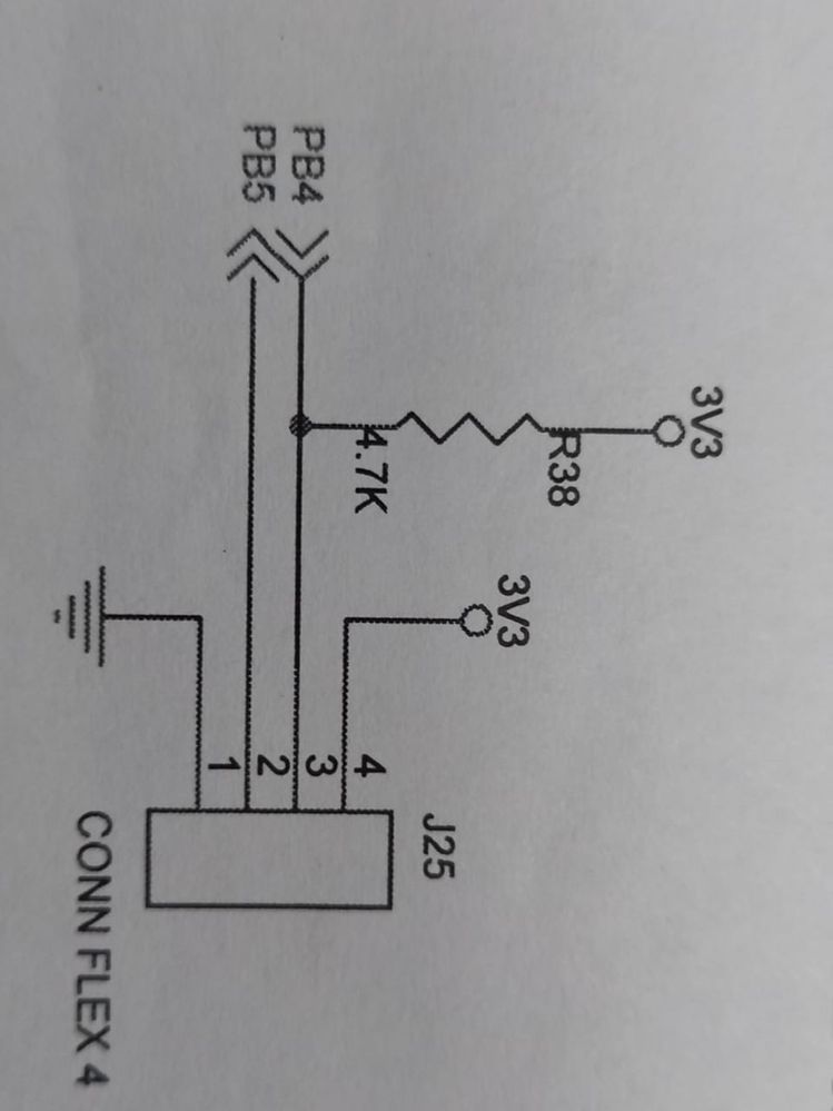

@harry123 wrote:
- Can I try connecting PB4 and PB5 and GND of arm processor directly to the USART1 pin PA9 and PA10 and GND of my nucleo board through J25(in image)
Which "ARM processor" are you talking about? Both the STM32 and the AT91SAM9G45 are ARM processors!
@harry123 wrote:
- Will the logic level be same between both the boards.
You need to study the board documentation for that.

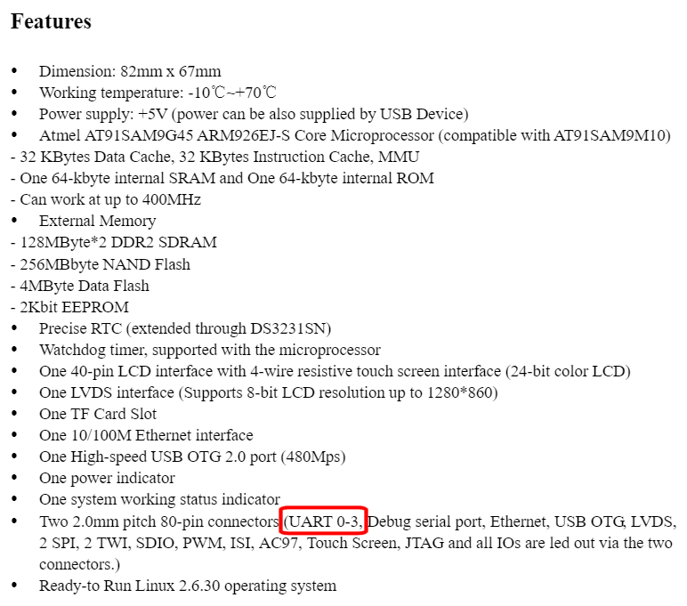

2024-09-25 4:23 AM
AT91SAM9G45 processor.
2024-09-25 4:34 AM
There's not enough information in that brief document - you need a more detailed technical manual.
But this Mini6045 board seems to be obsolete and no longer supported - so no idea where you'll find that.
