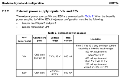

Go to the product page -> Documentation -> User manual.
https://www.st.com/en/evaluation-tools/nucleo-f411re.html#documentation
The User Manual has a section to describe how to provide power externally.
