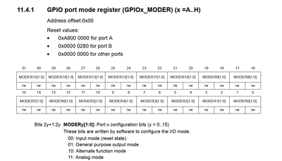

You can see this in rm , gpio settings at reset :
-> not all 00 , some on alternate function ->  for JTAG/SWD etc.
