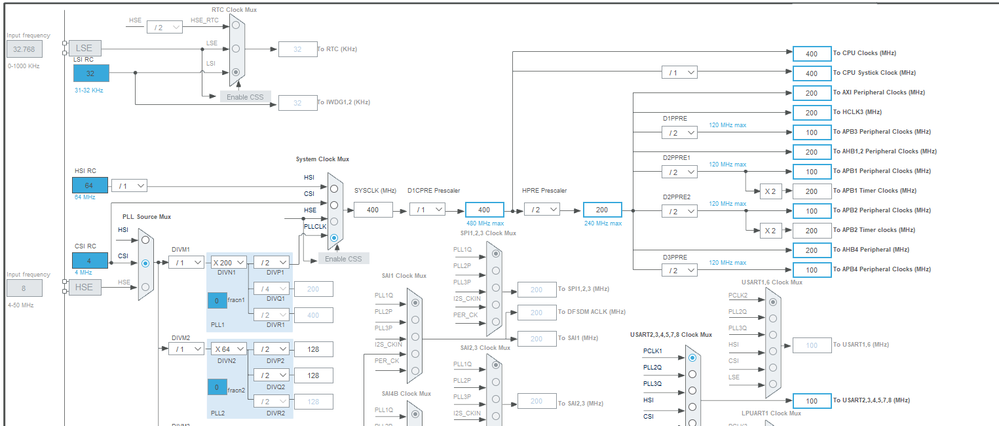

Does anyone how to clock the NUCLEO-H753ZI to 480MHz?
With this clock configuration it runs perfectly on 400Mhz, if I put the DIVN1 from the PLL1 a little above 200, in order to get a clock speed over 400MHz the board is stuck. STM32CubeMX and STM32CubeIDE give no error, the code compiles fine, but when I upload the .elf file the board is bricked.
It should be able to run on 480MHz.

Hello @TVan .8,
I advise you this article: How to reach 480MHz for STM32H7xx MCUs?
Please follow the described steps to run on 480MHz.
Hope this helped you:
Imen

2023-10-31 12:42 AM
Thx, I will try this.
2023-10-31 12:59 AM
This worked, great!
