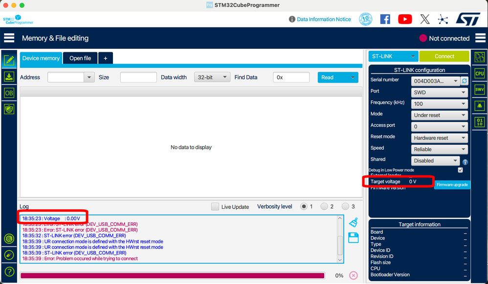

Here is also a view of my Programmer while I try the connect under reset. I read that the 0V is an issue but I am lost on what to do next. I am using the most recent version of Programmer available for Mac.

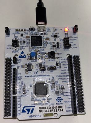

LD3 not lit indicates no 5 V power. LD1 solid red indicates the ST-Link connected okay.
Is the JP5 jumper present?
Recovery would be to hold BOOT0 high (to 3.3V) while pressing the reset. That should let you connect, unless there's a hardware failure.
What does/did the firmware on it do?
Don't place on conductive surface.
User the schematic to probe around and find out where 5 V power is getting stopped. Probably the USB power is coming in okay if LD1 is on.

As @TDK suggested, your Target has no power:
