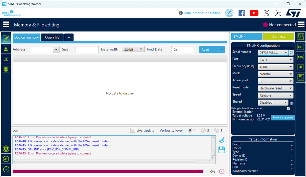

Nope...
12:42:17 : UR connection mode is defined with the HWrst reset mode
12:42:22 : UR connection mode is defined with the HWrst reset mode
12:42:22 : ST-LINK error (DEV_USB_COMM_ERR)
12:42:22 : Error: Problem occured while trying to connect
Serial console through STLINK _is_ working, and shows my startup message, so the USB connection is good.
