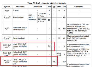

2025-03-12 3:29 AM - edited 2025-03-12 3:34 AM
From the datasheet:
Vout min (buffer ON) = 0,2V
Vout min (buffer OFF) = 0,5mV (a typical value).
So I think 1,2mV is something expected by adding the measurements errors ..
