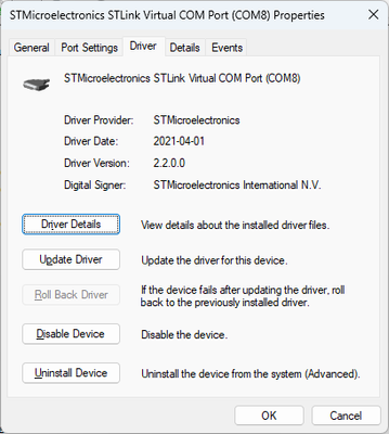

@dyMath6 wrote:I'm left with the port drivers though I'm not sure where to look for that
In device manager double click or right click and select properties. The go to the driver tab.

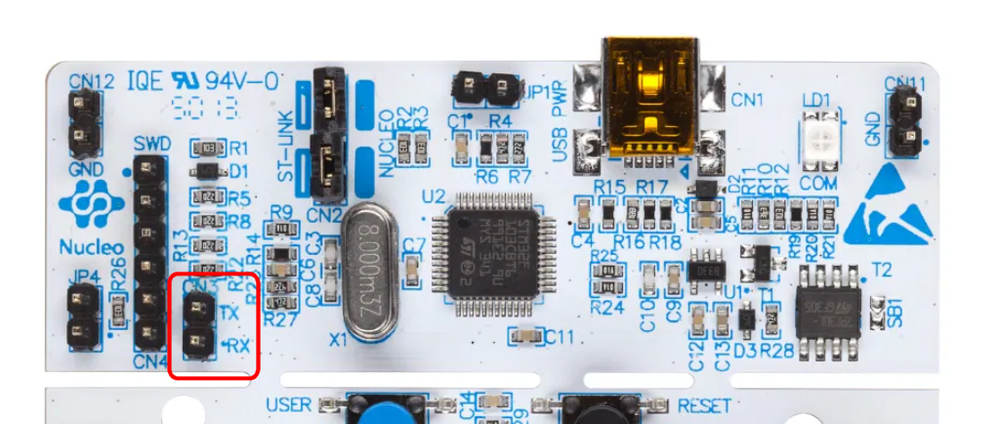

Have you tried the oscilloscope test yet to see if there is any activity?
Your NUCLEO-F072RB board has a jumper - CN3 - on the ST-Link section where you can probe:

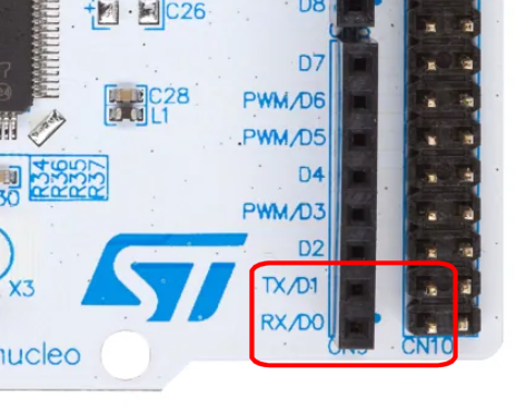

Also probe on the Arduino CN9 header:
(and/or CN10).
Do you see activity on TX when the STM32 is transmitting ?
Do you see activity on RX when the terminal is transmitting ?
PS:
If you disable the TX & RX pins on the STM32F072 Target, you can put a jumper on CN3 and do a loop-back test from the terminal.

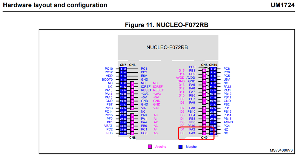

@Andrew Neil wrote:(and/or CN10)
Note that the Arduino D1 and D2 pins (CN9.2 & CN9.1) are connected to CN10 pins 35 & 37:
via: https://www.st.com/en/evaluation-tools/nucleo-f072rb.html#documentation
