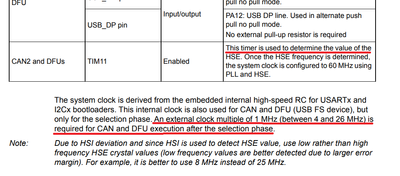

I think  the issue is related to the fact you lost HSE frequency which was generated by the STLINL module (MCO output).
For DFU and CAN bootloader you need an external clock either with an external crystal or with the STLINK MCO output (8MHz), or even with an external precise clock source GBF or similar ..

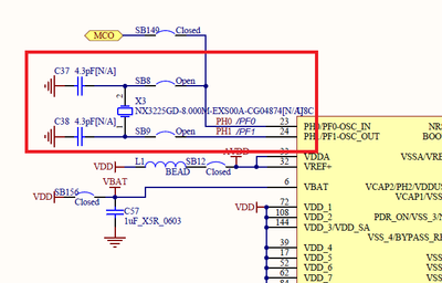

So you need to solder an external crystal (Example 8MHz) with its load caps:

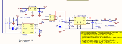

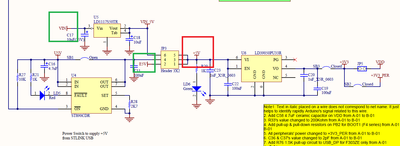

What power you set after the STLINK module was detached from the board?
Do you get 5V at the input of the U6 regulator? check the voltage on 1,3,5 JP3:
Need to have a power supply either on VIN (7 V to 12 V) or 5V on E5V (CN11/6):

hello, If I was seeing this glass issue, I think that's the problem I'm having. These days I get a crystal and try it, another question I don't get 4p3 capacitors, I get 4p or 4p7, are there no problems with that?
thanks for your response.
I think it could not induce an issue.
