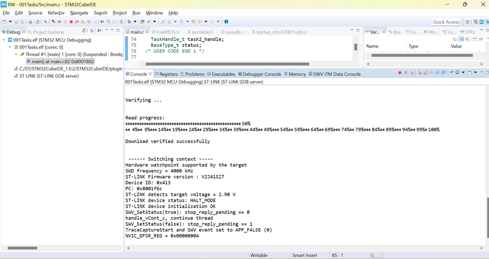

2023-04-01 1:51 AM
Board : STM32F407VG MCU * New order code STM32F407G-DISC1
I am trying to integrate freeRTOS and run a sample program using SWD pin. I am getting the below error and log(partial)
[3.688] spawnCubeProgrammer(): 13:52:50:876 Download verified successfully
[3.688] spawnCubeProgrammer(): ------ Switching context -----
[3.693] reset_hw_wtchpt_module(): Hardware watchpoint supported by the target
[3.693] Device_Initialise(): SWD frequency = 4000 kHz
[3.693] Device_Initialise(): ST-LINK Firmware version : V2J41S27
[3.693] Device_Initialise(): Device ID: 0x413
[3.693] Device_Initialise(): PC: 0x8001f6c
[3.709] Device_Initialise(): ST-LINK detects target voltage = 2.90 V
[3.709] Device_Initialise(): ST-LINK device status: HALT_MODE
[3.709] initServerContext(): ST-LINK device initialization OK
[3.709] write(): <632> Tx: $OK#9a
[3.709] read(): <632> Rx: $T1#85
[3.709] read(): <632> Rx: $m8001f6c,4#95
[3.709] handlePacket(): Reading 0x4 bytes of memory from addr 0x8001f6c
[3.709] write(): <632> Tx: $dff834d0#63
[3.709] read(): <632> Rx: $m8001f6c,2#93
[3.709] handlePacket(): Reading 0x2 bytes of memory from addr 0x8001f6c
[3.709] write(): <632> Tx: $dff8#68
[3.709] read(): <632> Rx: $m8001f6e,2#95
[3.709] handlePacket(): Reading 0x2 bytes of memory from addr 0x8001f6e
[3.709] write(): <632> Tx: $34d0#fb
[3.727] read(): <632> Rx: $qXfer:threads:read::0,bfb#fb
[3.727] write(): <632> Tx: $l<?xml version="1.0"?><threads><thread id="1" core="0" name="main"></thread></threads>#8b
[3.789] read(): <632> Rx: $m8001800,40#5e
[3.789] handlePacket(): Reading 0x40 bytes of memory from addr 0x8001800
[3.789] write(): <632> Tx: $02affef765fe00f041f800f0a9f807f10803019302230093174bc8221749184801f052f978617b69012b09d04ff0500383f31188bff36f8fbff34f8f3b61fee7#f0
[3.789] read(): <632> Rx: $m8001802,2#2e
[3.789] handlePacket(): Reading 0x2 bytes of memory from addr 0x8001802
[3.789] write(): <632> Tx: $fef7#68
[3.804] read(): <632> Rx: $Z1,8001802,2#78
[3.805] write(): <632> Tx: $OK#9a
[3.805] read(): <632> Rx: $vCont;c#a8
[3.805] SWV_SetStatus(): SWV_SetStatus(true): stop_reply_pending == 0
[3.820] handle_vCont_c(): handle_vCont_c, continue thread
[3.820] write(): <632> Tx: $OK#9a
[3.836] SWV_SetStatus(): SWV_SetStatus(false): stop_reply_pending == 1
[3.836] handleGDBConnection(): TraceCaptureStart and SWV event set to APP_FALSE (0)
[3.852] Device_GetHaltReason(): NVIC_DFSR_REG = 0x0000000A
[3.852] write(): <632> Tx: %Stop:T05hwbreak:;thread:1;core:0;#7e
[3.852] read(): <632> Rx: $vStopped#55
[3.852] write(): <632> Tx: $OK#9a
[3.852] read(): <632> Rx: $g#67
[3.852] write(): <632> Tx: $000000207800000000000008b5010008000000000000000000000000e0ff01200000000000000000000000000000000000000000d8ff0120a31f0008021800080000006100000000000000000000000000000000000000000000000000000000000000000000000000000000000000000000000000000000000000000000000000000000000000000000000000000000000000000000000000000000000000000000000000000000000000000000000000000000000000000000000000000000000000000000000000000000000000000000000000000000d8ff012000000000#e0
[3.870] read(): <632> Rx: $qXfer:threads:read::0,bfb#fb
[3.870] write(): <632> Tx: $l<?xml version="1.0"?><threads><thread id="1" core="0" name="main"></thread></threads>#8b
[3.870] read(): <632> Rx: $z1,8001802,2#98
[3.870] write(): <632> Tx: $OK#9a
[3.871] read(): <632> Rx: $m8001802,4#30
[3.871] handlePacket(): Reading 0x4 bytes of memory from addr 0x8001802
[3.871] write(): <632> Tx: $fef765fe#9e
[3.878] read(): <632> Rx: $T1#85
[3.878] write(): <632> Tx: $OK#9a
[3.899] read(): <632> Rx: $qXfer:threads:read::0,bfb#fb
[3.899] write(): <632> Tx: $l<?xml version="1.0"?><threads><thread id="1" core="0" name="main"></thread></threads>#8b

For what you need SWV. ?
2023-04-04 5:47 AM
Sorry, it is not SWV. Confiured SWO pin for supportinng printf style debugging
2023-04-04 6:35 AM
Hello @SNaga.6 ?
Could you, please, attach a screenshot of the debug configuration.
Thanks,
Rim
2023-04-04 9:23 AM
Check SB12 for SWO/PB3 operation
