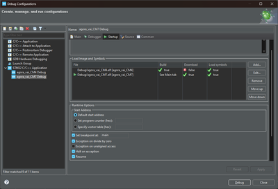

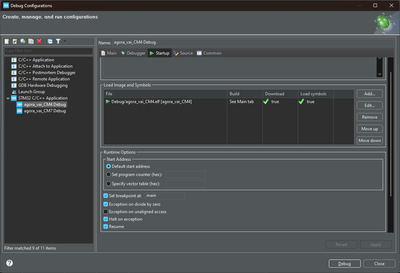

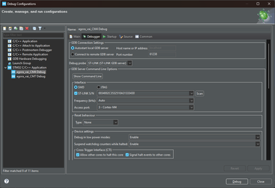

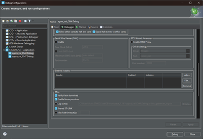

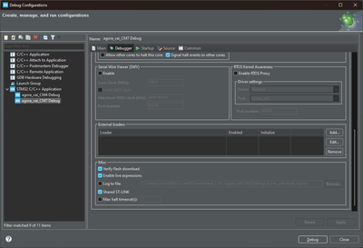

/* USER CODE END 3 */The Debugger CM7 config:
CM7 Debug page1
CM7 Debug page2
The Debugger CM4 config:
CM4 Debugger page1
CM4 Debugger page2
Startup config:
CM7 Startup
CM4 Startup

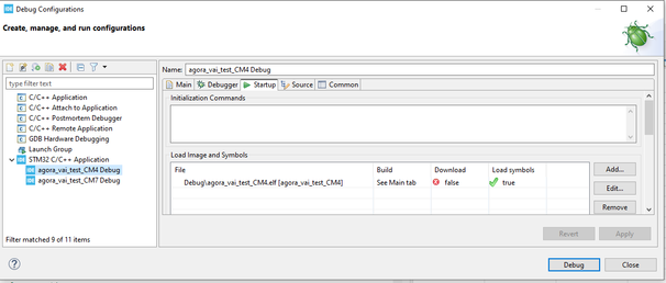

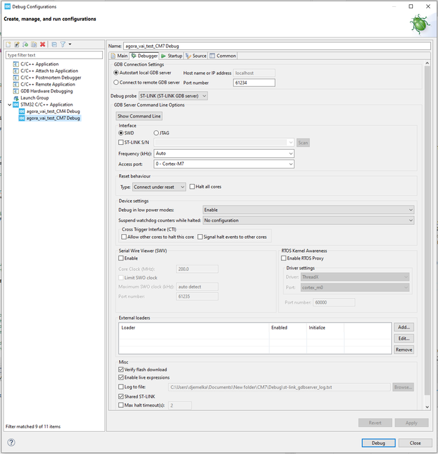

Hello @victorsj ,

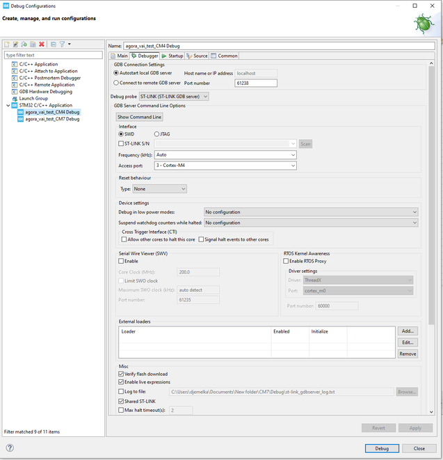

Could you please try to uncheck the ST-LINK S/N in the Debugger configuration:

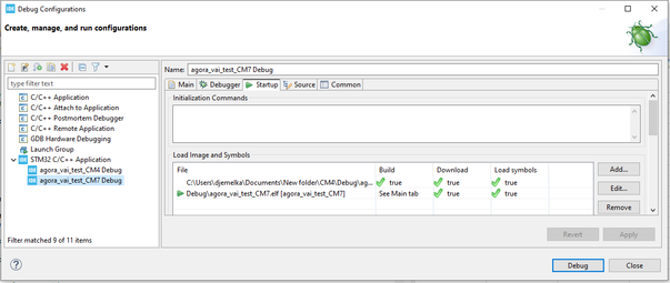

Please make sure in "CM7 startup" that the "Download" of "Debug\agora_vai_test_CM4.elf" is "true" as shown in the below figure.
Please make sure in "CM4 startup" that the "Download" of "Debug\agora_vai_test_CM4.elf" is "false" as shown in the below figure.
I tested your project using Nucleo-H755ZI-Q and STM32CubeIDE1.14.1 and it works correctly.
I hope this help you!

Hello @victorsj ,
