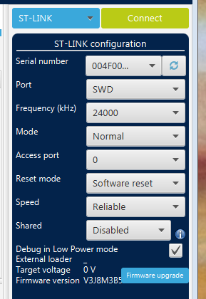

on Win hear USB connection, ding-****, see in STMCubeProgrammer -> refresh :
and in hardware manager on windows ->
and on stlink-V3 red LED on - otherwise take another cable and USB port...
