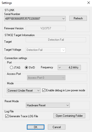

I purchased the official ST Link V2 from mouser but I cannot get simple SWD to work at all.
The PC can detect it and I can update its firmware but it will not detect target projects/boards no matter what I do.
I have tried many different configurations in ST-LINK Utility and STM32CubeIDE without success.
Is there anything I can try? Am I missing something?

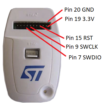

One common pitfall: For the STLink-V2-clones VDD is an output, and this pin can actually supply a target with some external circuits. Whereas for the original STLink-V2 VDD is an input used to set the proper thresholds for the level shifters. So the target must be supplied externally and STLink's VDD input connected to target's VDD.

Pin 1 needs to be powered from the target

Try with cube programmer, clone or wrong swd pins cabling or no powered mcu are possible causes.
