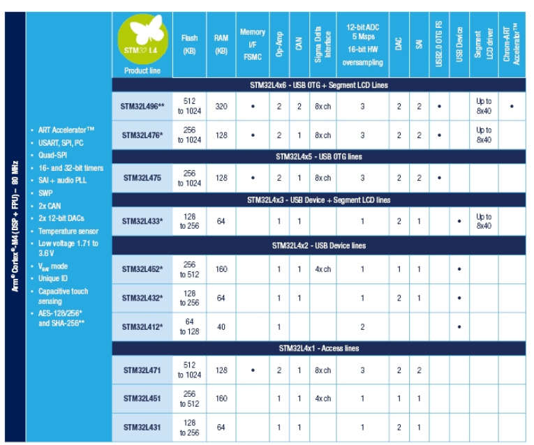

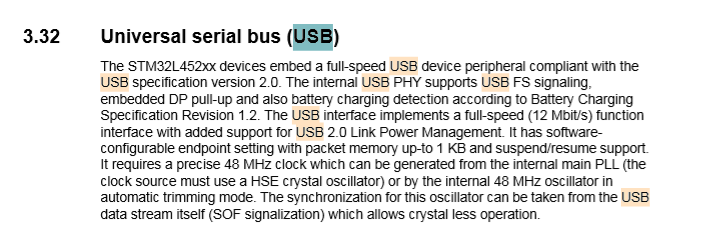

2019-08-09 4:50 AM
Hi Clive,
Thank for your response. Please find the snapshots for your reference. As per your suggestion I will go through Examples codes.
2019-08-09 5:14 AM
The predominant use case is as a USB DEVICE
2019-08-09 6:22 AM
Yes, it is a vital Role.
