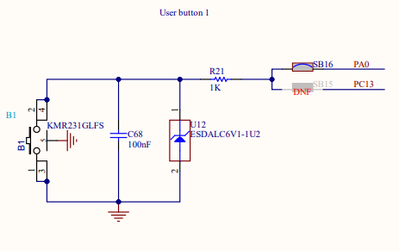

Here's the schematic of BUT1 pin. I'm not sure if the PA0 bypasses this connection, or if would only work if the button is pressed
Ok, so NUCLEO-WL55JC(1) board
You could remove the solder-bridge (SB16) or link, or move to PC13 (SB15) if nothing else conflicts, and use the EXTI15_9
That would free PA0 for your own, personal use, on the MORPHO connection/headers
Ok, so if I just remove the SB16 solder, the PA0 pin would be available to use on the MORPHO connectors, or simply just use the PC13 pin, right?

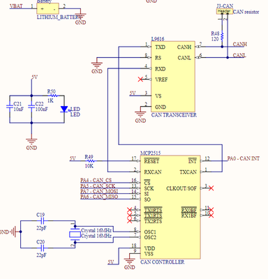

Ad per datasheet the int pin can be configured for different purposes.  Are you using any breakout,  then check the jumpers.  I  guess it needs pullups
Also don't know, here's the schematic on the board (consider PA0 as PB14 (CAN_INT_Pin))
