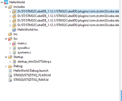

What i did:
1) Download STM32Cube IDE
2) clicked "new STM32 project"
3) picked my board from the list.
Thats it. All i got was this:
2024-05-13 3:05 PM
Thanks a lot. Already accepted your previous reply.
Im so new at this that i dont even know where a boundary of "DIY" is.
I clicked "generate new project" in STM32, it generated couple of random files, and thats all i got to ride with.
