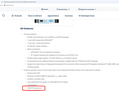

@mƎALLEm wrote:There is no CAN transceiver on NUCLEO-F446RE board ... If you need to use CAN in normal mode you need to add a CAN transceiver. .
So the Product Page is misleading.

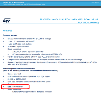

Also the Data Brief:
2024-12-16 8:08 AM - edited 2024-12-16 8:17 AM

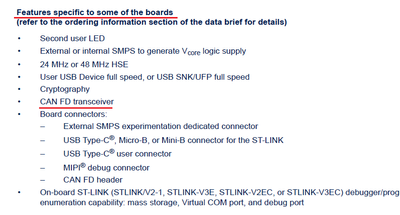

DB mentions it's specific for some boards:

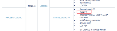

And it seems NUCLEO-C092RC board has indeed a CAN transceiver:

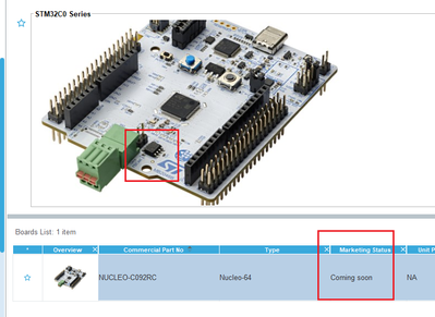

I think the board is not yet available on the market, but according to the image from CubeMx:
The transceiver is there:
The board status is marked as Coming soon.

2024-12-16 8:56 AM
Ah, to be fair the Product Page does include "Features specific to some of the boards (refer to the ordering information section of the data brief for details)"
But, as the Product Page refers specifically to just one particular board, it really should focus on just that board.
