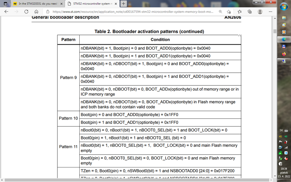

Read AN2606 and dont mix SWD with system loader.
After first load or before you need meet Pattern 11 for boot to system ...
or can jump to it from your app...
2022-04-15 2:40 PM
Thanks for the suggestion this is putting me on the right track.
There are 4 different patterns that I can chose from. To keep it simple lets call them ABCD.
The factory default is BOOT_LOCK = 0, nBOOT1 = 1, nBOOT_SEL = 1, and nBOOT0 = 1.
That corresponds to C the third pattern. because Flash Memory is empty, this causes it to go into System memory where the bootloader is. Once it was programmed, because I did not know about the Option Bits I left them at the default, and so it would not let me reprogram it again. Which is what I was seeing.
It appears the only way to make it work is to use B the second configuration. Because I am already bring BOOT0 pin High. It means I have to change nBOOT_SEL from the default of 1 to 0. nBOOT1 bit is already 1, and BOOT_LOCK bit is already 0, And nBOOT0 bit doesn't matter.
Next I have to figure out how to change the bits using the HAL, because unlocking the flash looks complicated.
Thanks for the pointer.
I will post again when it is working.
