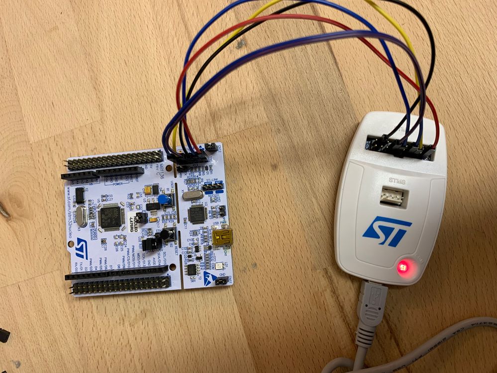

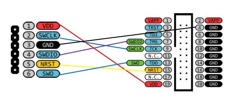

I'm using this guide: https://stm32-base.org/guides/connecting-your-debugger.html.
2022-02-17 1:51 PM
That header on the Nucleo board is meant to use the Nucleo's STLink to debug an EXTERNAL device instead of the on-board CPU. It is not intended to allow you to connect an external STLink to the Nucleo to debug the on-board CPU.
In addition to that show stopped [EDIT: stopper] - the Nuclep board CN4 pin 1 (VDD) does NOT power the Nucleo board, It is meant for the on-bioard STLink to sense the EXTERNAL device's VDD.

ok thanks, that explains a lot:see_no_evil_monkey: :grinning_face: . Is there any way to test the ST-Link/v2 with the Nucleo board?
2022-02-17 2:27 PM
this works but I want to test the ST-Link/v2

2022-02-19 10:47 AM
Power Nucleo board externally (e.g. via internal STLink USB-connector), remove jumpers on CN2, connect external STLink SWCLK and SWDIO to CN2, pin 2 and pin 4, respectively (and of course GND). The internal STLink will still supply MCO and 'block' SWO, USART_TX, USART_RX pins, if you don't like this, short SB11 to keep internal STLink in reset state.
If you use an original STLink-V2, don't forget to connect STLink's VAPP pin to target's VDD.
