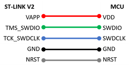

2023-05-26 3:19 AM - edited 2023-11-20 4:31 AM
from the ST-LINK
This is the connection
2023-05-26 5:12 AM
Check on board: is CPU vdd 3.3 V ?
And connect: software reset mode .
