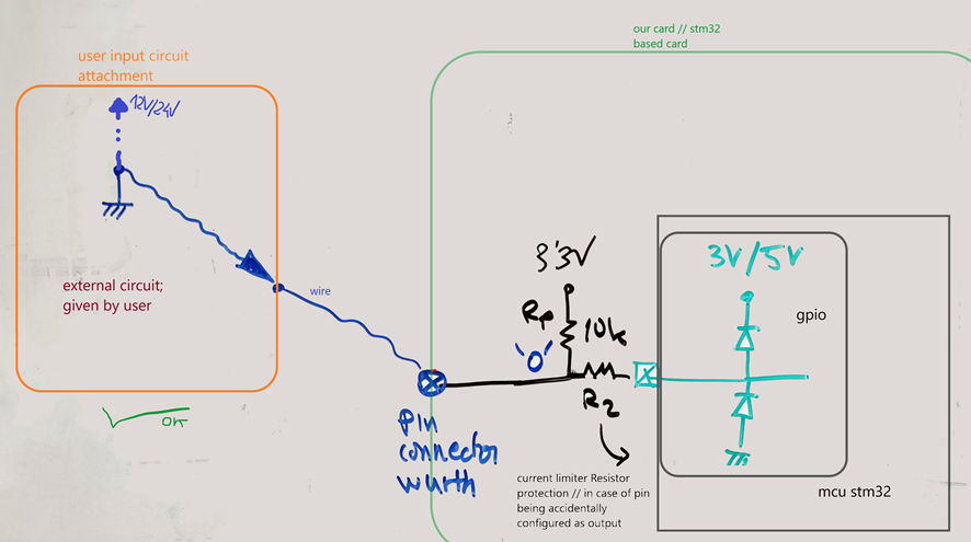

From the outside, our card interface could be seen as '0' detection and '0' writable card (a kind NPN inputs, NPN outputs "concept"). We can read '0' and we can also put '0' in order to close external input/output circuitry. The card reads GND and it also gives GND to the user attached circuits.

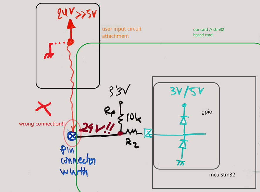

Said this, users must give 'GND' or "highZ" to the inputs. The inputs user's circuits should not put positive voltages here (neither negative), except by an user error. The problem I see here is when user's attached circuit VCC is V>3.3V/5V and user "puts" 12V, 24V, etc. node there (input pin) by error/mistake. As I have read in datasheet, pins allow less than 3.3V/5V (depends of kind of pin).

All right connected external input circuit:
Error connection between user input circuit and our card:
NOTE: R2 = 600~1K2
Before considering optos devices as a solution, I would like to know how to give a protection against putting voltages greater than 3.3V/5V at input pins: fuses, TVS, zener...
