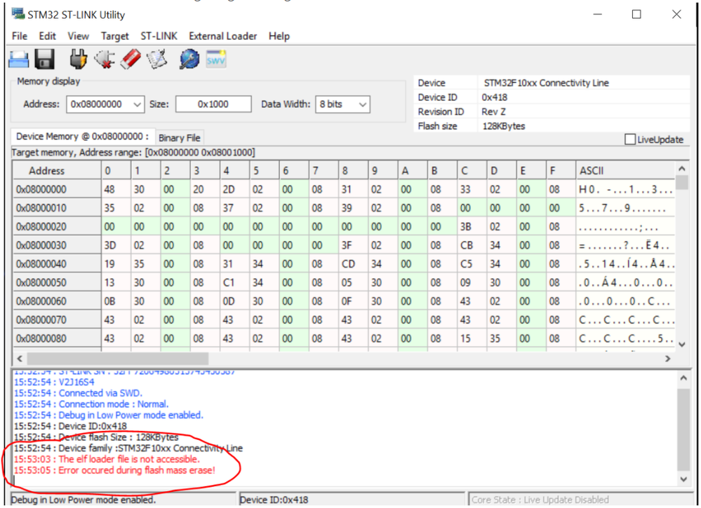

I tried to erase the controller but getting following error

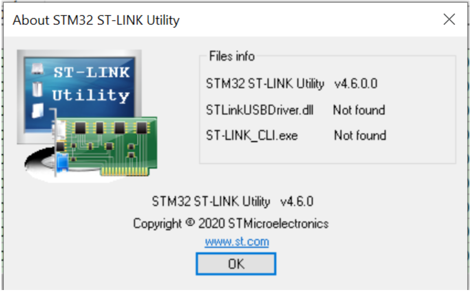

Then I checked in about info I get following info
I am able to connect with target but not able to perform any action. Please rectify the issue & suggest best way to program controller using GUI.

This is the about info ST-LINK utility
Below is the error message when I tying to erase the program
