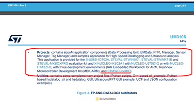

User Manual UM3106, Getting started with the STM32Cube function pack for high speed datalogging and ultrasound processing
via:
https://www.st.com/en/embedded-software/fp-sns-datalog2.html#documentation
2024-06-18 8:29 AM
I was using the wrong IDE !
I was using "S32 Design Studio" instead of STM32 Cube IDE"

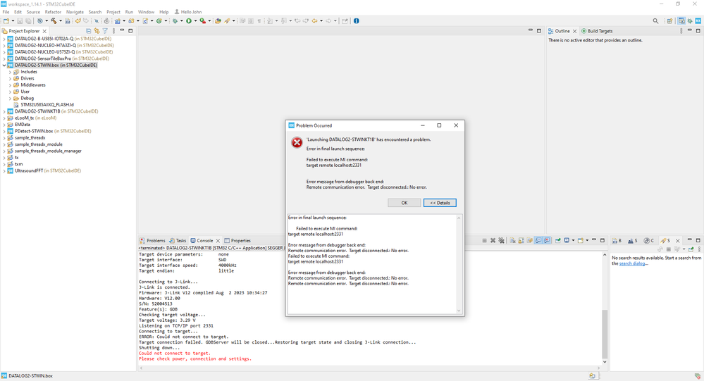

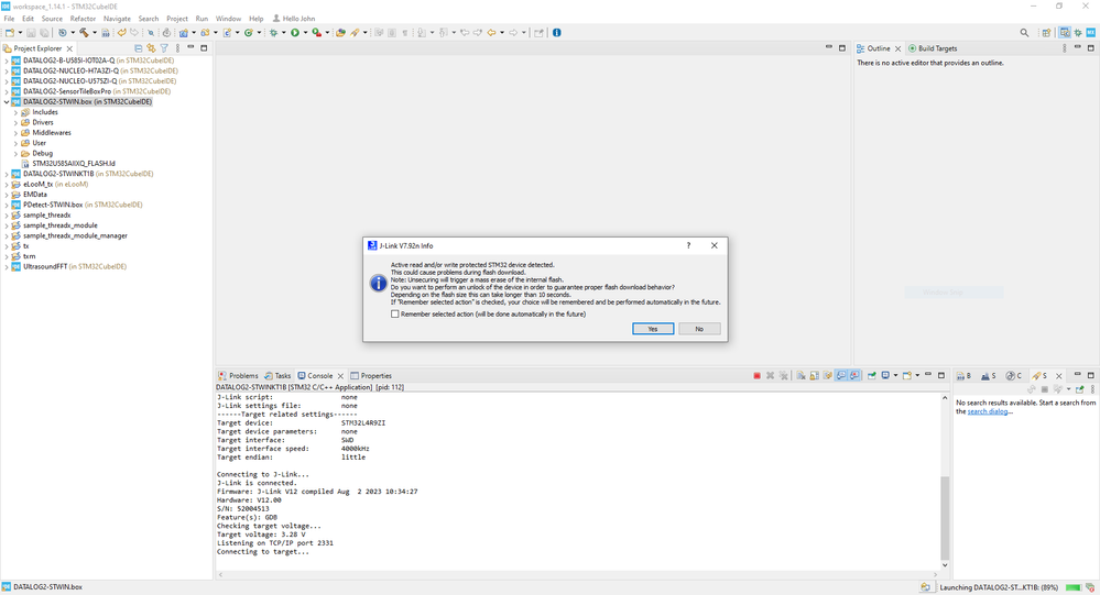

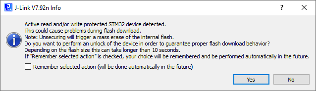

I am using a Segger J-Link Base to try and flash/debug the DATALOG2-STWIN.box application, but get the following warning...

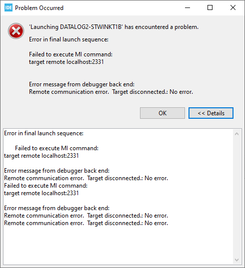

If I select yes (multiple times) I then get the following error...

Seem to have fixed it, there was no power to the board (even though the battery was connected) so I powered the board via the USB connector
