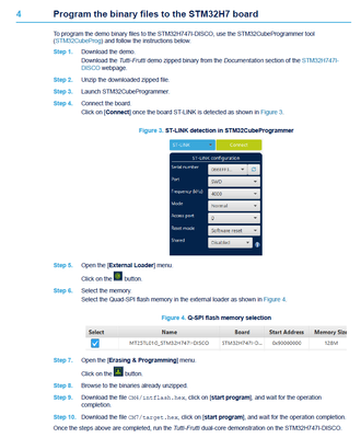

I have an STM32H747I-DISCO board that I am trying to bring up with the Tutti Frutti Demo.   I have followed the instructions in UM3008 to program this as it appeared to be blank upon arrival from Digikey.
External loader was set to:  MT25TL01G_STM32H747I-DISCO
Programming of CM4 with intflash.hex and CM7 with target.hex completed successfully.

So the question here did you follow the steps described in the UM3008 / Section: "4 Program the binary files to the STM32H7 board":
If you followed these steps, it could be due to an incompatible version of the LCD. The marking I have on the board I'm using: MB1166-A03
