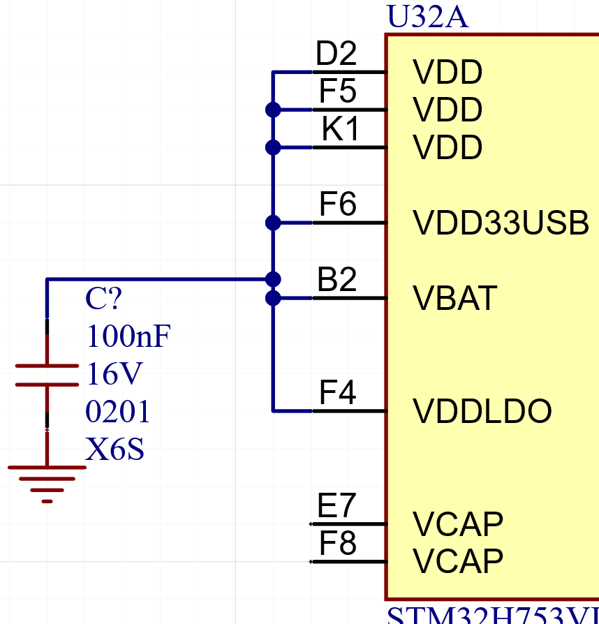

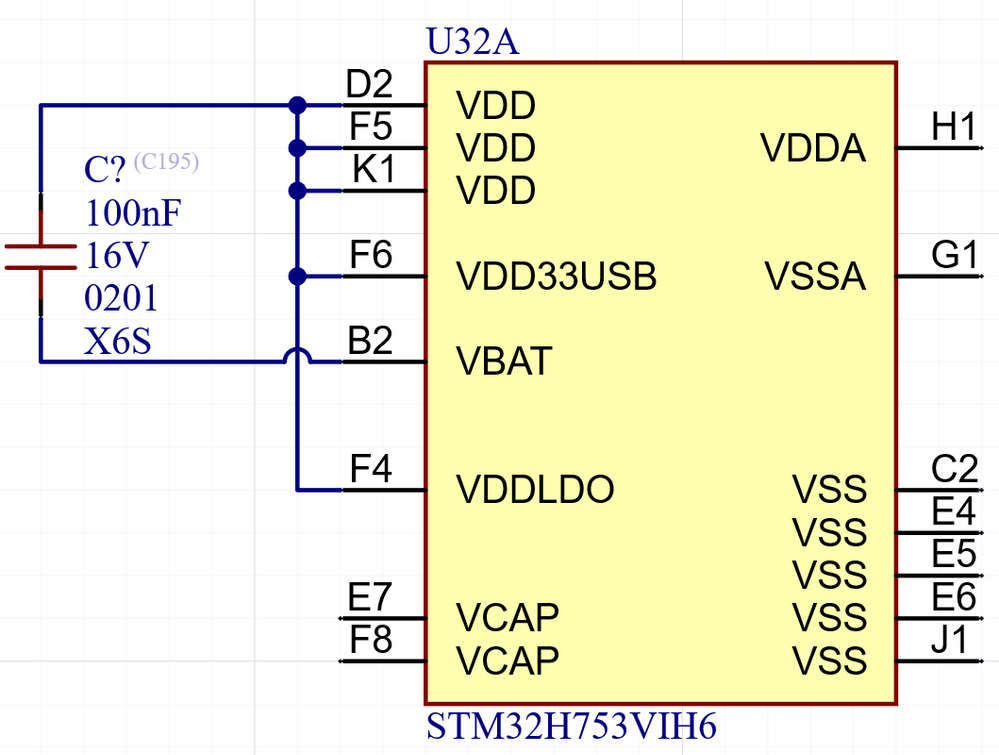

Section 6.4.4 of RM0433 is the only place I could find that says what to do with VBAT rail when not using a battery. It says the following:
If no external battery is used in the application, it is recommended to connect VBAT externally to VDD through a 100 nF external ceramic capacitor.
Does it actually mean "through"? That wording implies this:
...but I don't see how that make sense.
Does anyone else read it differently?

Welcome, @NAbun.1, to the community!
This is indeed misleading and means that you should connect VBAT to VDD and from that connection connect the capacitor to GND.

2022-09-22 11:12 AM
Thank you for the warm welcome! I am just getting into the STM32 micros and have a lot to learn.
I believe you did answer my question, thanks!
