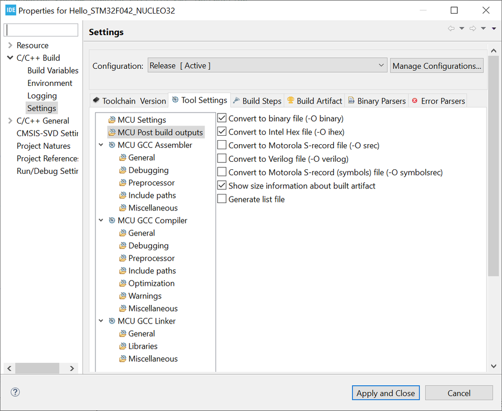

2019-08-14 11:03 AM
Enabling the binary/hex check boxes in Project > Settings works fine for me:

2019-08-15 10:22 AM
I had set the binary/hex checkboxes for my Release configuration and I have updated STM32CubeIDE Version 1.0.2, , but I am still not generating .hex or .bin executables. Also, looking at the internally-generated makefile, there appears to be no command to build .hex or .bin; only .elf.....?
