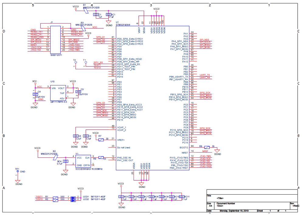

2019-09-25 9:10 PM
Here my schematic capture files atttached.
NRST Pin check oscilloscope
Power on : NRST near 0 voltage
System Workbench for STM32 program debug image click : NRST near 3.3 voltage
You'll see about a VCAP.
In my schematic, VCAP1, VCAP2 is conneected GND.
Thank you.
