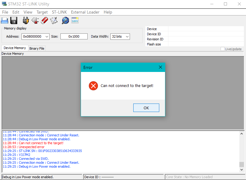

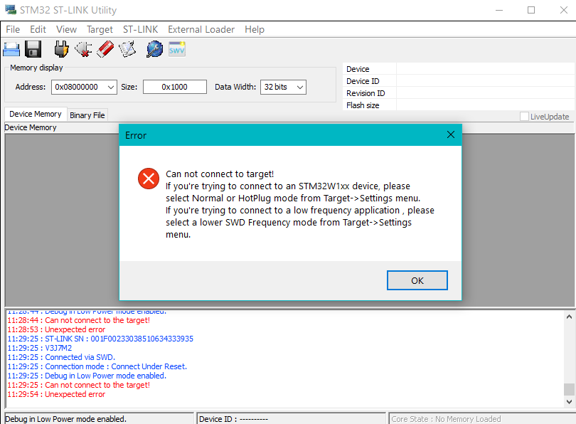

The port is showing in device manager and I can update/downgrade the firmware but I cant flash it. I had some similar problem with a bluepill but I put BOOT0 on 1 and erased the chip. After that it worked. I did the same with this board but it tells me cant connect to the target. I tried also with connect under reset. Nothing works...
2022-07-29 1:42 AM
Don't use ST-LINK Utilities, want to be using STM32 Cube Programmer
If you get the LDO/SMPS settings messed up I'd suggest the following methodology for H7's
Put a jumper on board so you can pull/drive BOOT0 high. The NUCLEO-144's have VDD/BOOT0 pins next to each other to help facilitate.
With the jumper on power cycle the board a couple of time, complete disconnect USB, and reattach, do this twice counting out 5 seconds at each step.
Then when finally reconnected use STM32 Cube Programmer to Erase chip.
Remove jumper
Fix your code
Proceed

2022-07-29 1:52 AM
you are god, I will call you master Tesla DeLorean from now on. Jesus, I never thought to disconnect and reattach the board. Also yes, using ST LINK utilities was a mistake, thank you so much!

Well I got the board and just updated the firmware and next time when I wanted to flash, just didn't recognized anymore ( the port was showing ). I got the same issue with the STM32F103C8T6 but with that it worked to erase the chip with ST LINK UTILITY. They definitely need to make a jumper for every board for BOOT 0 if this still happens...
