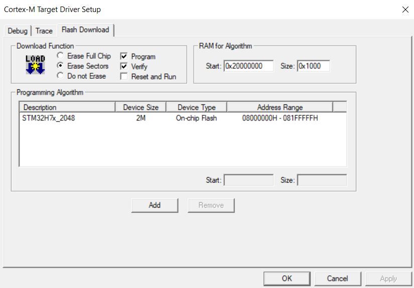

Go into the Flash settings and switch between the H7 Single/Dual bank algorithm, and make sure the algo is for the 0x08000000 memory space.

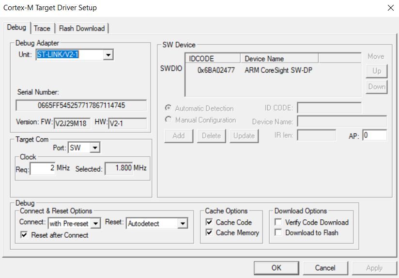

What version of uV5? Current DLL and Firmware for the ST-LINK?
2019-11-14 3:50 PM
Thank you. Please see the following setting. What do you think is the problem?
2019-11-14 4:03 PM
2019-11-14 5:06 PM
I'd start by updating the ST-LINK firmware V2J35 is more current
