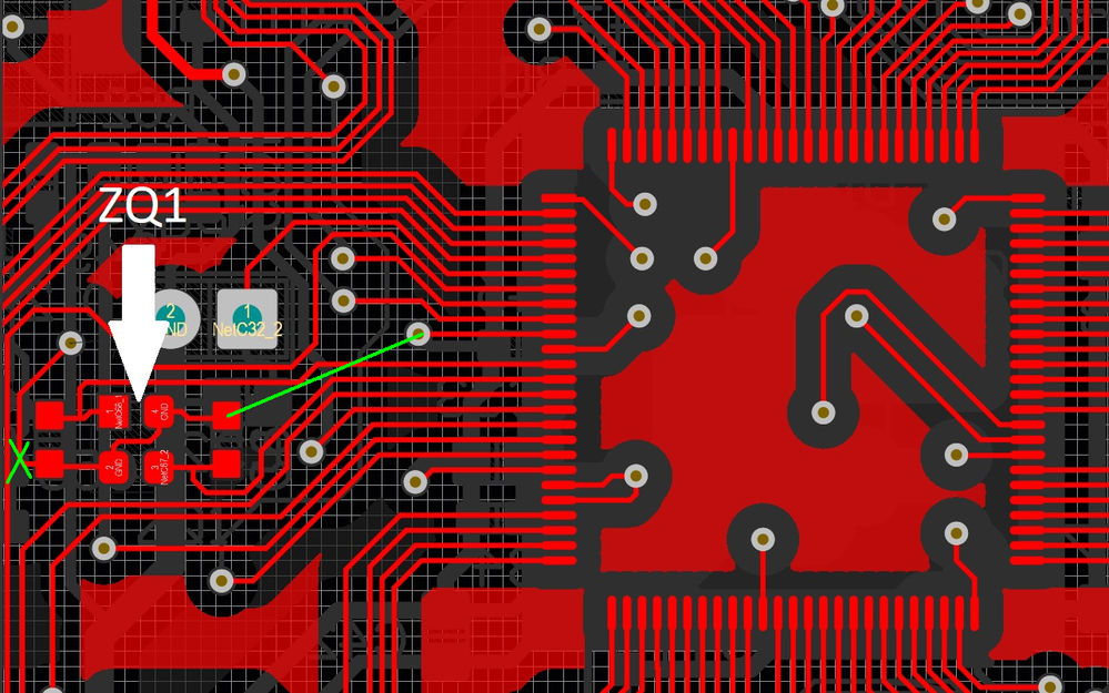

The HSE tracks are too long, but what's much worse is the ground routing - it MUST go from the capacitors to the nearest VSS pin (pin 10) the shortest possible way.
Cut the trace from capacitors to the via to ground, and connect it using a wire to the via which comes from pin 10. 0693W00000BaRkHQAV.png

Super User
> The oscilloscope measured the power lines for surges.
We are talking about millivolts here. The oscillator is a relatively low-power analog circuit.
PS. Meals... okay, that's a funny google autotranslation, Питание in this context translates to "supply"... :)
