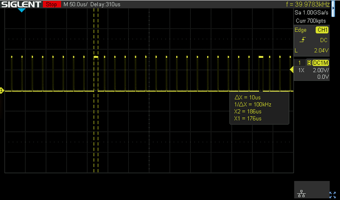

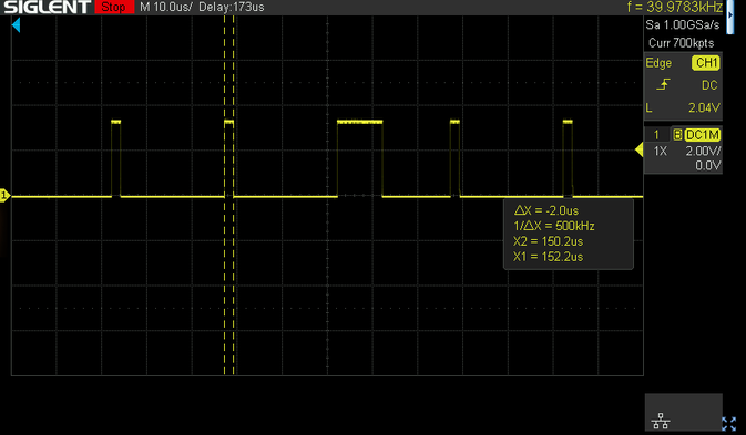

Associate II
I want to generate a timeslot control signal consisting of one 10-microsecond pulse followed by fifteen 2-microsecond pulses.
I want the period to remain constant, aligned on the falling edge.
My problem is that before and after the long pulse, the period changes, and I don’t know how to fix it.
I have:
instead of:
I use two methods and i am not able to make both of them work.
Here is my code:

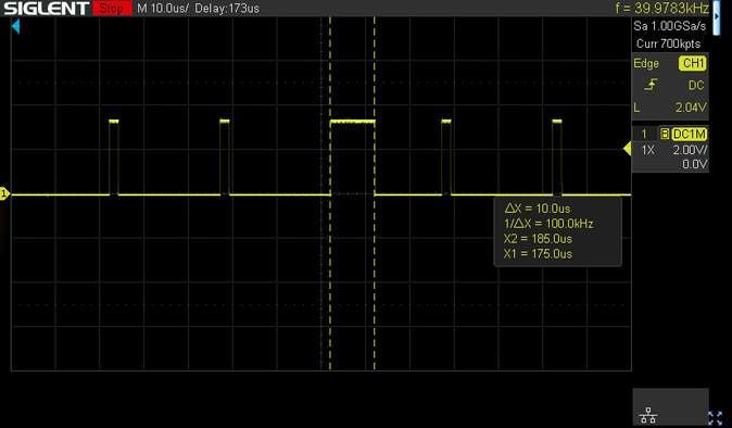

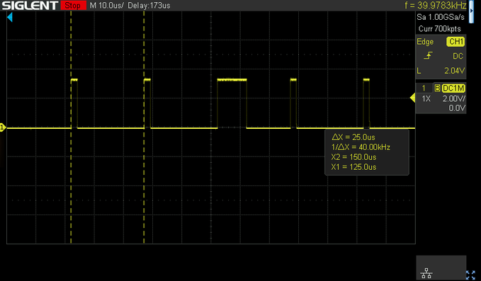

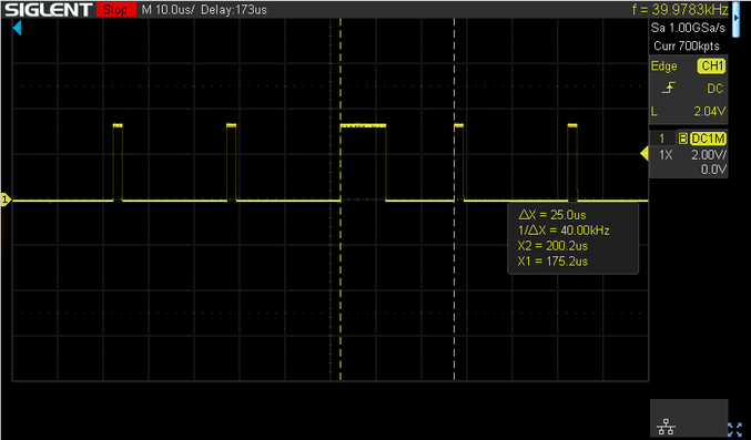

I just use the HAL_TIM_PWM_ConfigChannel to change the pulse
15 pulses at 2us and 1 pulse at 10us
period is 25us
10us long pulse
2us short pulses
TIM_OC_InitTypeDef sConfigOC = {0};
void InitTim15(void)
	sConfigOC.OCMode = TIM_OCMODE_PWM1;
	sConfigOC.Pulse = 33;
	sConfigOC.OCPolarity = TIM_OCPOLARITY_HIGH;
	sConfigOC.OCNPolarity = TIM_OCNPOLARITY_HIGH;
	sConfigOC.OCFastMode = TIM_OCFAST_DISABLE;
	sConfigOC.OCIdleState = TIM_OCIDLESTATE_RESET;
	sConfigOC.OCNIdleState = TIM_OCNIDLESTATE_RESET;
volatile uint32_t pulseCount = 0;
void HAL_TIM_PWM_PulseFinishedCallback(TIM_HandleTypeDef *htim)
	if(pulseCount == 15)
		sConfigOC.Pulse = 160;
		if (HAL_TIM_PWM_ConfigChannel(&htim15, &sConfigOC, TIM_CHANNEL_2) != HAL_OK)
			Error_Handler();
	else if(pulseCount == 16)
		pulseCount = 0; // reset
			Error_Handler();
	++pulseCount;

Oh, after a second read, you do want the period to be constant. Just invert the polarity of the channel from what you're already doing. You'll need to specify the negative duration instead of the positive duration, but then the period will line up with the falling edge instead of the rising.
Another option would be to use downcounting instead of upcounting.
it does work thank very much, i was loosing my mind trying to do this.
