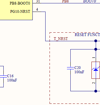

Check C20 capacitor: already there? kept its value?
LCE
Principal II
C20 still there, never touched / changed it, soldering looks good.
