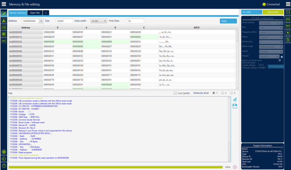

When I check device memory in STM32CubeProgrammer, I see that the first data location is at address 0x08000000 (screenshot attached). This makes me wonder if I also need a bootloader file for it to work. If so, where would I obtain it?

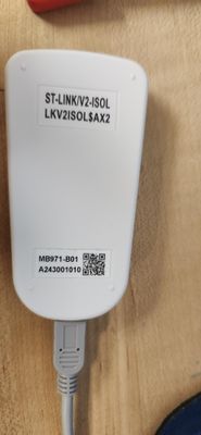

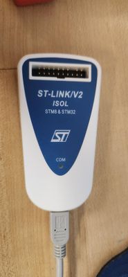

Please note that you have posted your question in the public Community. However, the firmware was provided to you by the personal Online Support OLS upon signing an SLA. Therefore no one here in the community will be able to answer your questions, so please open a new ticket in OLS and refer to your old ticket number 00235149. Please also include photos of the front and back of the ST-LINK/V2 to that ticket so that our colleagues can check whether it is an original.

Regarding the ST-Link/V2, I purchased it from Mouser, so it should be authentic. It has successfully connected to the control card and was able to program it, as shown in the screenshot I attached to the post.

The ST-LINK/V2-ISOL looks original; at least, I have not come across any fakes that look the same.
