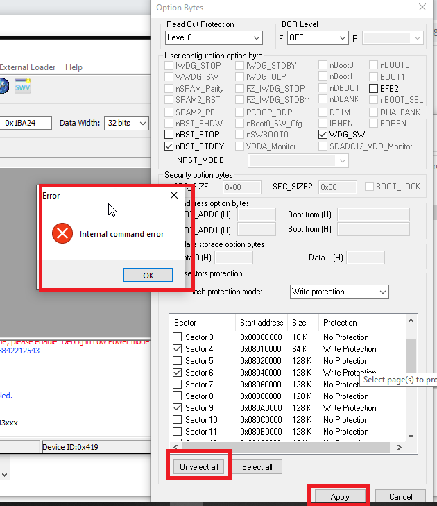

I am having an issue with the firmware update on STM32F427 MCU by using the ST-Link utility tool and Keil debugging functionality. When I reload the new program on MCU, sporadically flash erase step marking few sectors are write-protected. I used the Option Bytes option to unselect all->Apply command, but the command threw an internal command error.
I tried with ST_Link command utility also, it does not help

2021-10-21 7:48 AM
You can try using STM32CubeProgrammer instead.
If option bytes are getting set to random values, perhaps delve into when/why that's happening in the first place and correct. It is not normal behavior.
2021-10-22 2:00 PM
Thanks for the response, indeed the cube programmer application is able to reset the write-protected flag. I observed this flag resetting issue when I use the Keil debugger, whereas if I use the command line flash erase and reprogramming the MMU does not create any issue. Have you come across any issues with the Keil debugger before?
