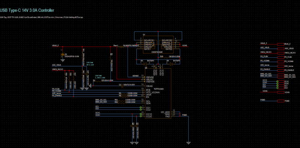

I use STM32U5+TCPP03-M20 with UCPD interface, and the external protection circuit is to merge consumer and provider paths in a single bi-directional(bi-MOSFET pair) power path. There is one USB-C PD connector for both 5v/9v/12v power(SINK application) adapter and 300mA fan load(SOURCE application, Ra=5.1k).
The TCPP03-M20 datasheet(8.3) provides an example of a combined source/sink path using two Schottky diodes and a 1M resistor. According to the datasheet, I have built the 5V1A SOURCE.
The issue has been found during the SOURCE application test:
1) With the 300mA load connected(see below table #1), the VBUS voltage drops from 5v to 1.78V after bi-MOSFET pair. TCPP03-M20 status: Reg1=0x1c, Reg2=0x20, GDCG=4.530v, GDPG=4.525V, PD_VCONN=3.3V, PD_ENABLE=3.3V, PD_FLGN=3.3V
2) When I write 0x14 to Reg0, the Reg1 read stays at 0x18.

It is not recommend using consumer MOSFET (Q1 on X-NUCLEO-DRP1M1) to drive bi-directional power path because OCP will not be functional when provider because TCPP03-M20 internal high side amplifier must be ‘oriented’ according to the use case (consumer / provider). OCP when provider is mandatory to protect the system against a defective SINK product (short circuit as example).
According to the behavior of the system, it seems that MOSFET (STL40DN3LLH5) are in linear mode instead of saturation mode.
R48 = 2V confirms that point. Just a warning when performing the source to gate voltage measurement. Multimeter impedance on voltmeter mode must be very high impedance else gate driver current may shunt the current of the gate driver.
Indeed, gate driver current is around 15µA on short circuit.
5µA on R48 (1 MOhm) does not impact the normal behavior of the MOSFET because 10µA can drive the gate capacitance.
Voltage drop of the BAT30F4 (Schottky diode) is less than 0.2V according to figure 4 of the datasheet. It is negligible.
May be there is a leakage somewhere that limits the gate driver.
No Vgs measurement to avoid performance degradation induce by multimeter leakage.
Next, I would recommend checking around gate driver:
To identify / understand the MOSFET unexpected behavior.

2024-08-30 3:02 PM - edited 2024-08-30 4:55 PM
Hello Mathieu,
I very appreciate your analysis recommends.
Indeed, I am able to get my setup working after replace R48 with 10 Mohm(I don't have a 5Mohm in hand right now). The GDC/GDP is around 9v (reg1=0x1c, reg2=0x20). Is 'reg2=0x20' indicate VBUS_OK failure? Please also advise if there is any risk by using 10Mohm for Mass Production.

2024-09-02 1:57 AM
Hello Robert,
Increase R48 from 1MOhm to 10MOhm will increase opening time of MOSFET from around 600µs typical to 6ms typical with STL40DN3LLH5.
It does not affect the normal behavior of Type-C and Power Delivery. When used for protection, the use-cases have been analyzed without identifying any specific risks.
Reg2 = 0x20 indicates VBUS_OK. It is numerical information that indicates that VBUS >_VBUS UVLO (2.4V typ). For system point of view, it can be used to indicate that consumer path is active at start-up.

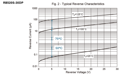

I got a TCPP03-M20 instability issue at the 3A high current charge after increasing R48 from 1MOhm to 5.1MOhm. After checking DS, I found this issue might caused by D5 and D6 current leakage at high PCB temperatures(around 60°C). After replacing D5 and D6 with RB520S-30DP-TP, TCPP03-M20 works normally at high PCB temperatures with DRP settings.
Before our design moves to the production stage, I would appreciate it if you could confirm those changes can be applied to TCPP03-M20.

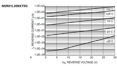

BAT30F4 (0201 package) presents a higher leakage current at 5V (simulation = 50µA at 60°C) than other diodes suggested on the datasheet.
In 0201 package, we propose : NSR01L30NXT5G that presents a low current leakage < 1.2µA current at 5V 75°C.
It’s better than RB520S-30DP-TP that graphical evaluation on datasheet provides around <2.2µA at 5V 75°C.
Designer has run Monte Carlo simulations (process + temperature up to 75°C + Vcc lower case) to check gate diver behavior : all is ok with above proposed diode.
I confirm that the solution is correct up to 75°C with 5MOhm + NSR01L30NXT5G.
Additional analysis is ongoing to recommend optimum diode to increase temperature working range.
