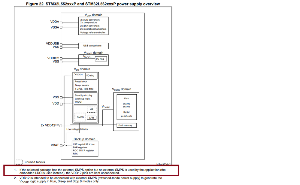

I have to use STM32L562CEU6P on my project.
This uP has two VDD12 pin for external SMPS.
My question is simple, this SMPS supply is required or can I left this pins floating?
I don't need this feature and manual is not very clear.
Thanks in advance.

Please refer to RM0438 (Section 8 Power control (PWR))
if an external SMPS is used, these pins must be connected.
otherwise (i.e. LDO is used for Vcore) these pins can be NC.

Thank you so much, I have not seen this note at my first look.
