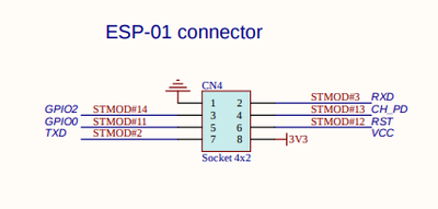

  1. How is GPIO0 wired on the MB1280 at the ESP-01 socket? Is it tied to GND by default?

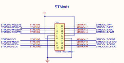

Schematics can be found under CAD Resources tab
https://www.st.com/en/evaluation-tools/stm32h747i-disco.html#cad-resources
https://www.st.com/resource/en/schematic_pack/mb1280-3v3-c01-schematic.pdf
https://www.st.com/resource/en/schematic_pack/mb1248-h747i-d04-schematic.pdf

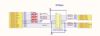

The GPIO0 connects to STMOD#11 (Pin 11) which is PC6 on the H747I-DISCO side
AScha.3
Super User
this ?
So seems on PC6 ; try set it hi...
