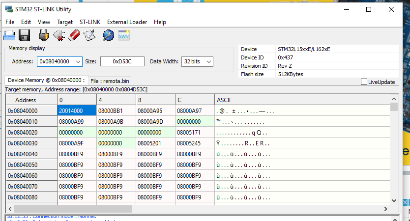

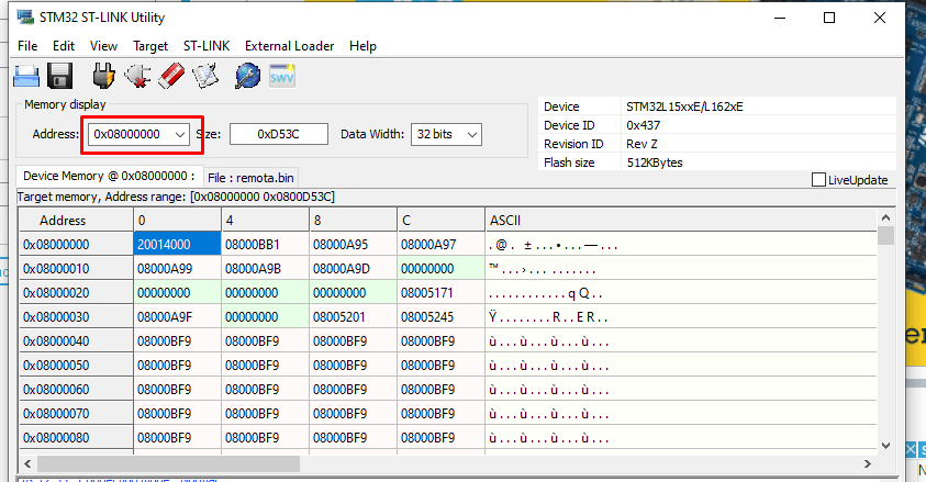

program was loaded on both regions 0x0800 0000 and 0x8004 0000

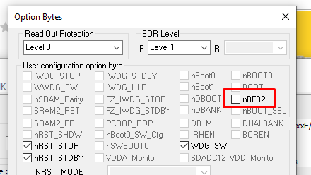

if nBFB2 is checked the code runs ok, if i just unched the code does not run....
what am i doing wrong?

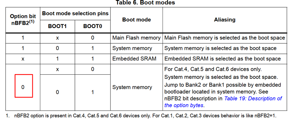

i am using a nucleo64 board MB1136, i replaced the original STM32L152RE with a STM32L151RE to ***** the dual boot, as i have verified the 152 does not have dual boot mode, is that right? or both of them work in dual boot mode?
but as i can see, if nBFB2 = 0 (unchecked), i.e. dual boot mode is active, the pins BOOT1 and BOOT0 does not matter, on booth cases the boot will be from "system memory", jumping to bank2 or bank1

in the aplication note AN2606 it says "If Value @0x08040000 is within int. SRAM address" > "Jump to user code in Bank2", the value 0x20014000 is a valid one?
when the system memory jumps to bank2, wich is in address 0x08040000, the flash address is automatic "remaped" to virtualy be in 0x8000 0000 wich is base address where originaly the code was compiled?

in AN2606, page 307 Figure 73. Bootloader selection for STM32L1xxxE devices, where it says "BFB2 = 0", its the same as "nBFB2 = checked" (it has a "n" in front) in the option bytes of the STM32 ST-LINK Utility?
i will always let the nBFB2 unchecked or checked?
i will change the value of the nBFB2 to choose bank1 or bank2 ? or i need to let it at always the same state and invalidate the first word at bank1 (0x0800 0000) or bank2 (0x0804 0000) to select wich firmware to run?
