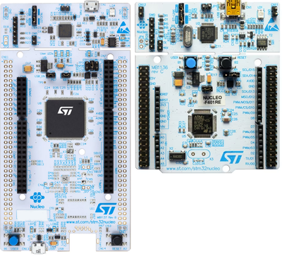

2025-08-08 9:04 AM
@Tesla DeLorean wrote:entirely different boards, with different pin counts
Indeed:
2025-08-08 9:15 AM
It's my view that you'd need to do a complete reappraisal of the pin usage, and look at all the stubs and escape paths to the different header arrangement.
It doesn't implement the Ethernet of the other NUCLEO-144's for parts that do, and I'd expect the Arduino shield connections to be going to different pins also.
One of the big issues with the NUCLEO-64 designs is that the Arduino shield D0/D1 clashed/share a UART resource with the VCP, and this gets avoided with more pins and UART escaped.
The double wide Arduino connector is a challenge, not seen a breakout / protoboard
You need different X-NUCLEO-GFX shields for NUCLEO-64 vs 144

@Tesla DeLorean wrote:The double wide Arduino connector is a challenge, not seen a breakout / protoboard
But there's the "Morpho" headers - which are on a standard, sensible, regular 0.1" pitch.
Have to fit them yourself, though.
