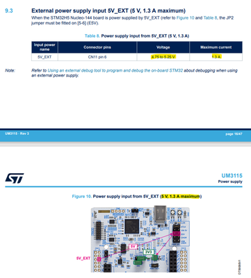

According to the UM3215, the E5V supports a voltage from 4.75 V to 5.25 V and a maximum current of 1.3 A. I think 12 V is very high. If these conditions aren’t respected, you risked damaging the board and the STM32MCU "The impact when STM32 MCUs operate above the absolute maximum ratings".

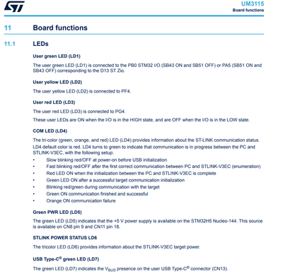

For the LEDs color means:
LD4: Red LED ON when the initialization between the PC and STLINK-V3EC is complete.
LD5: The green LED (LD5) indicates that the +5 V power supply is available on the STM32H5 Nucleo-144. This source is available on CN8 pin 9 and CN11 pin 18.
LD6: The tricolor LED (LD6) provides information about the STLINK-V3EC target power.
