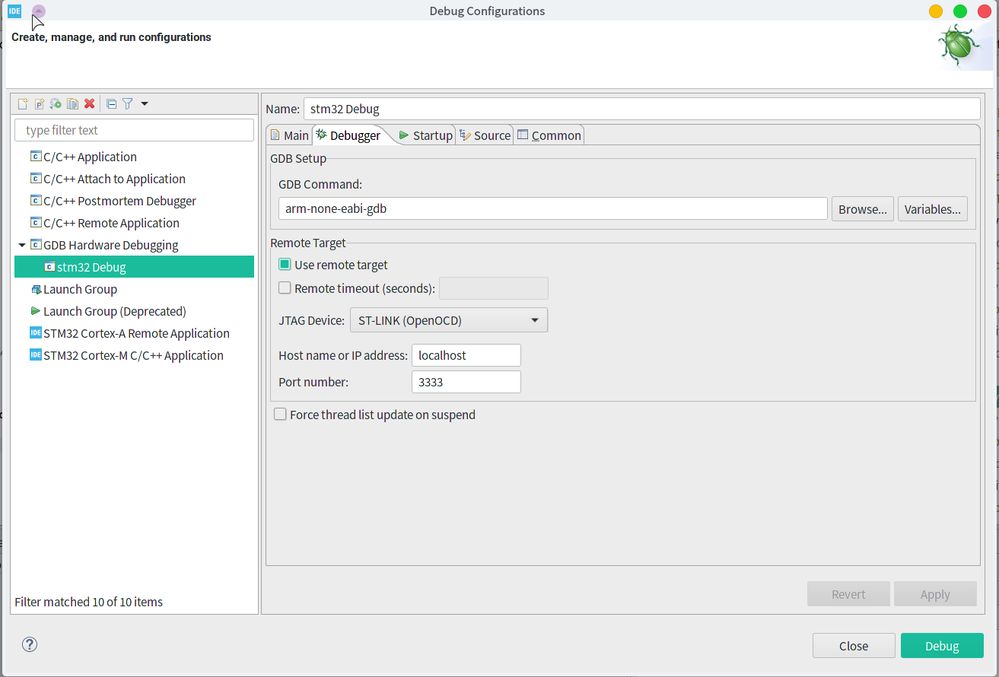

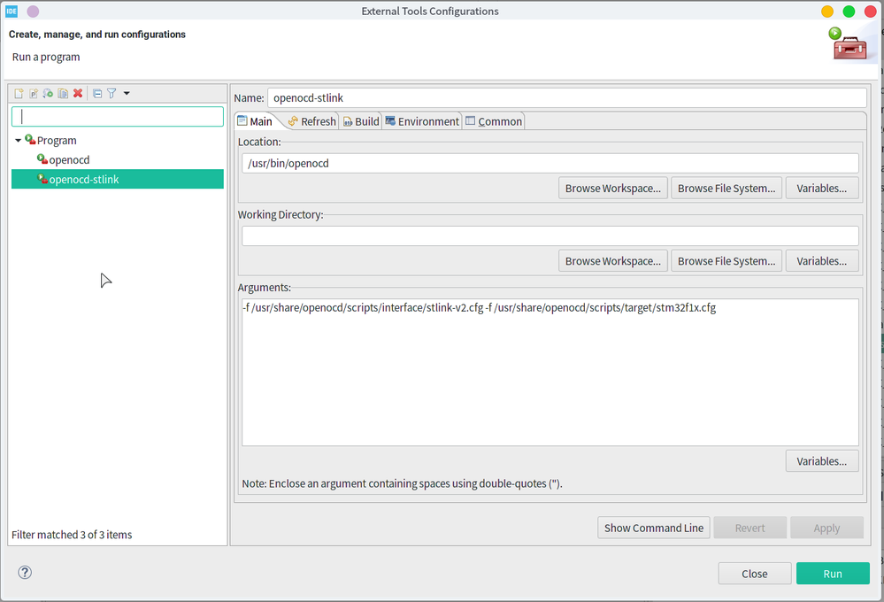

2 ways:

2024-10-07 7:50 PM
Hi I'm having the same problem on my MacBook
I've already downloaded the latest file but it doesn't work..
((((The following solved the problem for me (Windows 10, CubeIde 1.5.1):
I don't know how to solve this problem. The solution that you told me above can only be solved in Windows.
Could you give me a hand?
