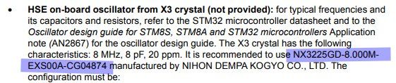

In UM1974 rev 10, section 6.8.1, page 25/84 a recommendation is given for the use of a particular crystal part number:
This part number does not exist.
I've searched on both Digikey and LCSC and in both there is only the part number
NX3225GD-8MHZ-EXS00A-CG04874
Please correct the document.

Hi @BarryWhit
Thank you. Good catch
An internal ticket 185310 has been reported to update the UM1974. It could be any crystal that is inline with AN2867.
