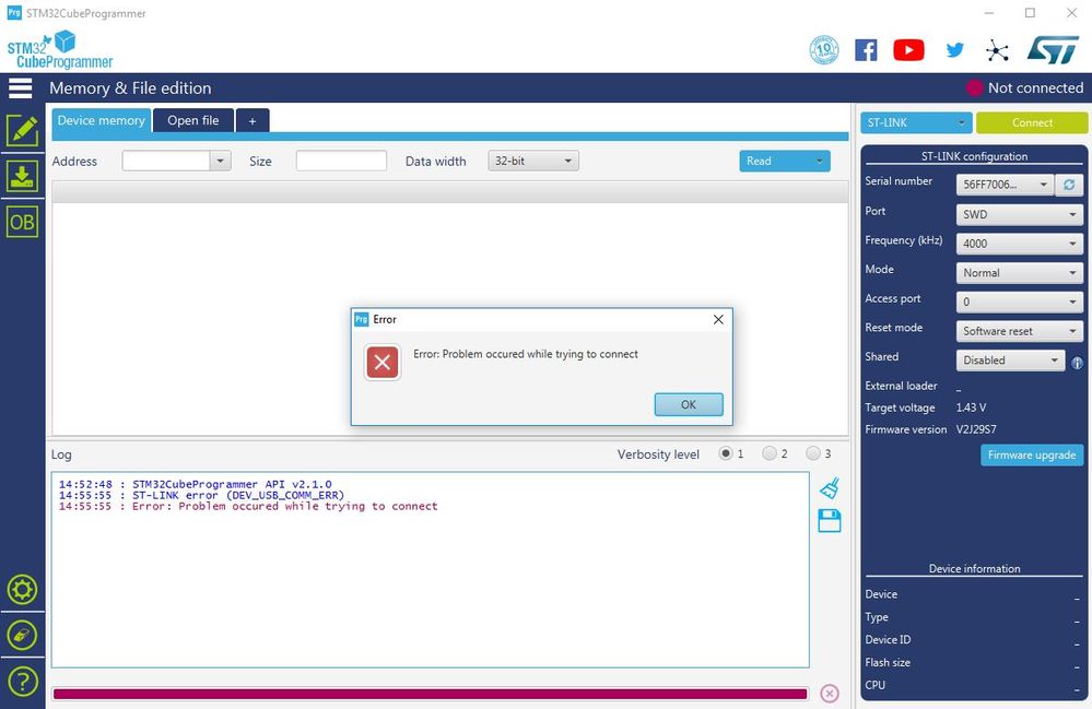

I'm working for the first time with an ST-LINK V2 on a Windows 10 laptop, and it doesn't work with an MCU or without it.
I am trying to isolate a problem, so I connecteed the ST-LINK on its own, without any attached wires, besides the USB that connects it to the computer.
When I'm connecting it to the laptop. I get STM32 STLink in the device manager.
On STM32 Cube Programmer, when I try to connect to it, I get the following:

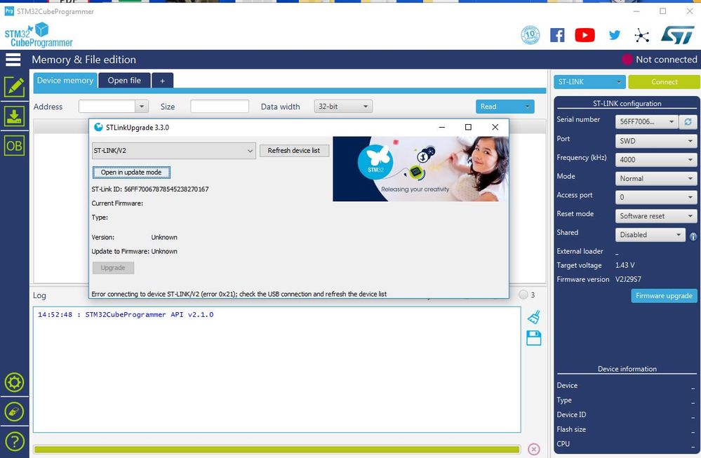

When I try to update its firmware, I get the following:
Is This normal?
If not, what does it indicate? how may I fix this?

2019-05-17 11:14 AM
OK, fixed.
For future generations:
Go over .all of your available USB port. you might the Chosen One.
