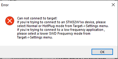

2. With external ST Link V2 USB dongle.
The device manager shows this for 2nd approach;
But, stLink utility sw responds with this; cannot connect to target.
Thanks

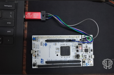

2023-11-01 5:21 AM
Thanks @MM..1 for quick answer.
The microcontroller side of the board looks ok. But, STLink part doesn't seem to get detected.
However, when I connect external StLink v2 clone, it doesn't get detected by st link utility sw.
Attaching image:
If this setup works at least, its enough for me to get started.
Can u check where it could go wrong?
Thanks
2023-11-01 5:54 AM
Try another computer. And another USB cable.
2023-11-01 6:06 AM
Aghhh your knowledge is under level for this designs.
1. Connector you use is designed for output from Nucleo programmer when is cutout NO as input, you create backpower loops ...
2. Your board need own powering before use external Stlink
3. From external Stlink start only with 3 wires GND SWDIO SWDCLK based on code inside MCU maybe fourth wire NRST is required, but your external clone dont have it. (RST on it is STM8 based)
