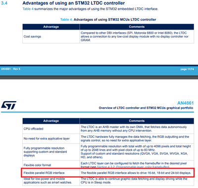

@LPZ I'm not an expert of that peripheral but from the AN4861 table 4:
if he is talking LTDC then we would have something like RGB323 format.
You would use pins R7, R6, R5, G7, G6, B7, B6, B5. Nobody is using something like this.
There is no such a thing.
RGB565 is the most popular.

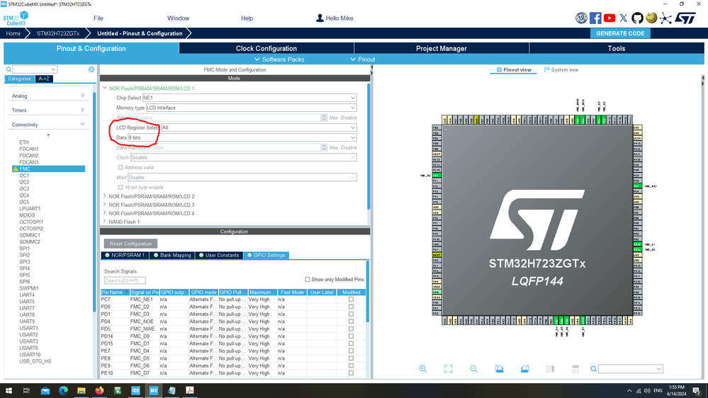

a have a few projects connected to 8 bit TFT and you use FMC not LTDC
