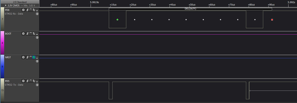

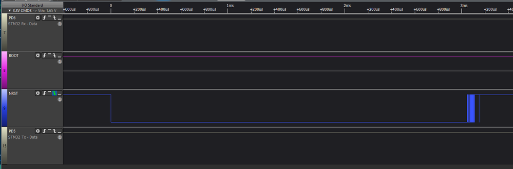

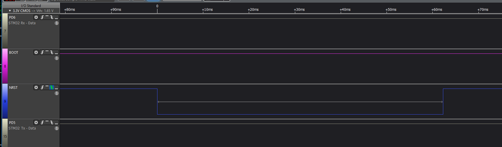

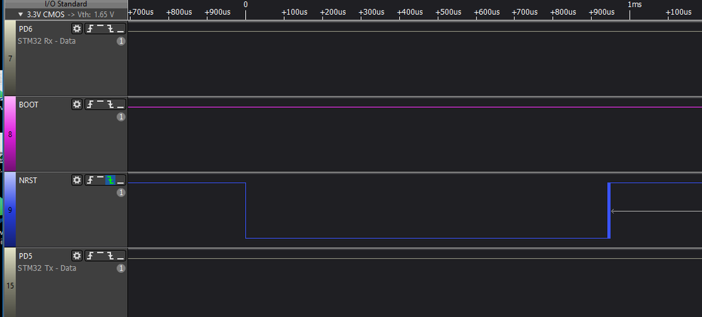

I have tried all the following, all of which have the BOOT0 pin connected to the 3V3 pin with a jumper. As for the power supply. I have tried with the power being supplied by the USB connector on ST-Link board that is part of the NUCLEO-F412ZG board. I have tried with a 6V adapter connected through VIN. I have tried powering with 5V on the E5V pin.

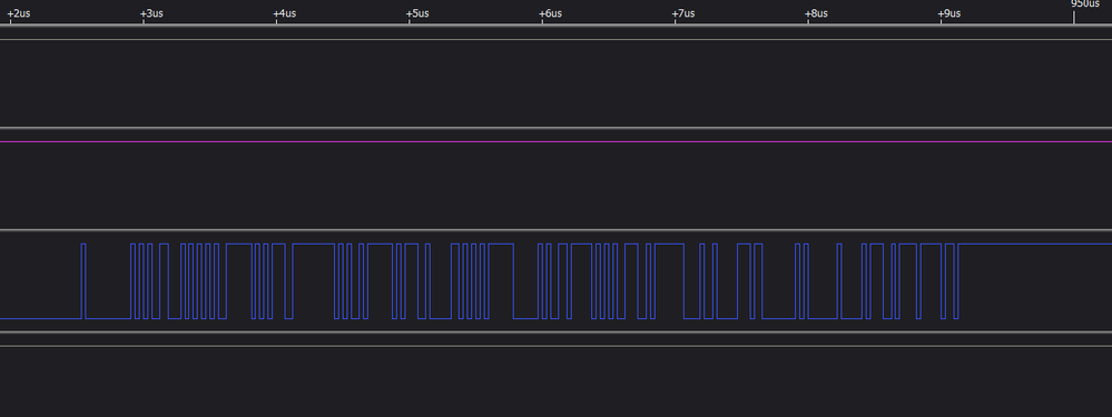

Also, I should have mentioned that I'm seeing some strange oscillation on the NRST pin when it driven to a high. I have tried adding an external pull up resistor to NRST pin, but it still is there and then isn't from the CP2102N GPIO pin.
With it not connected to the NRST pin.
And here is the whole conversation, including trying to connect with the STM32CubeProgramer (GUI v2.18.0, bootloader on board is v3.1, connection speed is 115200, but I have also tried 9600 with the same results)
Zoomed in to the trailing edge of NSRT.
Programmer connection part:
And one last observation, is that it looks like the STM32 sees "something" and tries to respond, with a 0xFF, but not at a matching baud rate. So, maybe it can't determine the right baud rate for some reason.
Also, I have tried this on two boards with the same result.
2025-02-26 12:03 PM
NRST is both input and output for STM32. If the program calls software reset, or watchdog goes off, the MCU will reset and pulse the NRST pin.
2025-02-26 12:15 PM
OK, thanks that explains the pulsing. Still have no idea what I'm doing wrong where I can't get it into bootloader mode when using the reset, but can if I cycle power.
