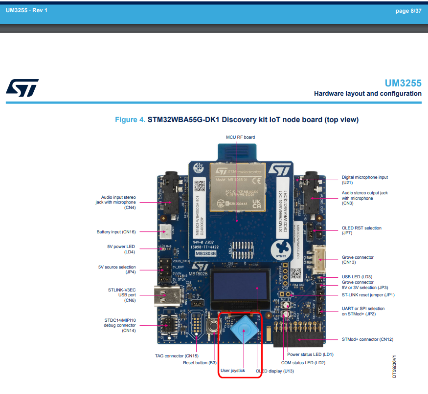

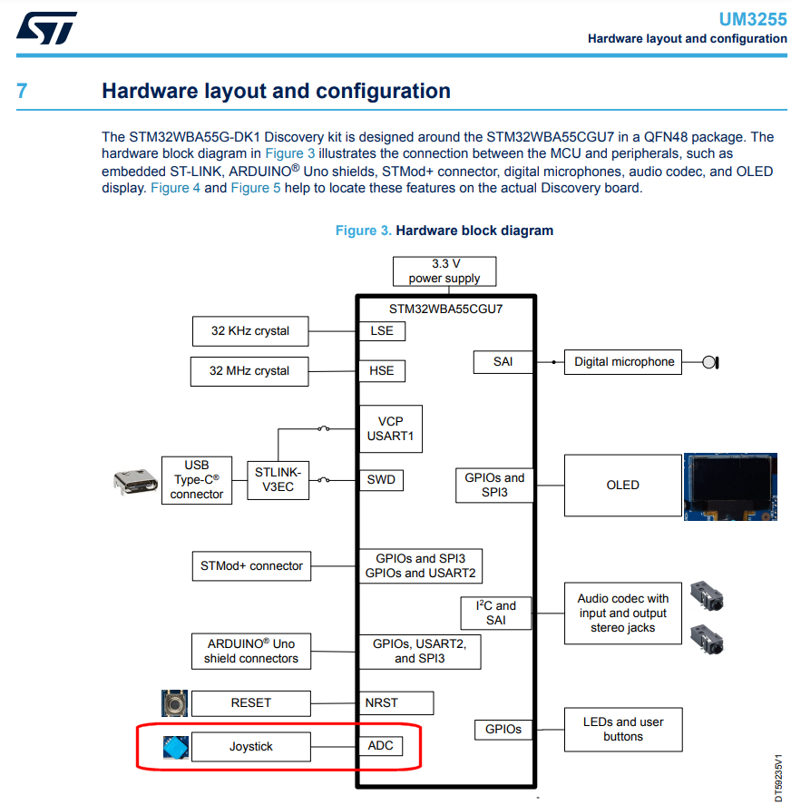

As @STTwo-32 said, it is referring to The Joystick which is part of the Discovery kit:
So you don't need to do anything - it's already done for you!
To use a Nucleo board, you'd have to replicate all those features of the Discovery kit
